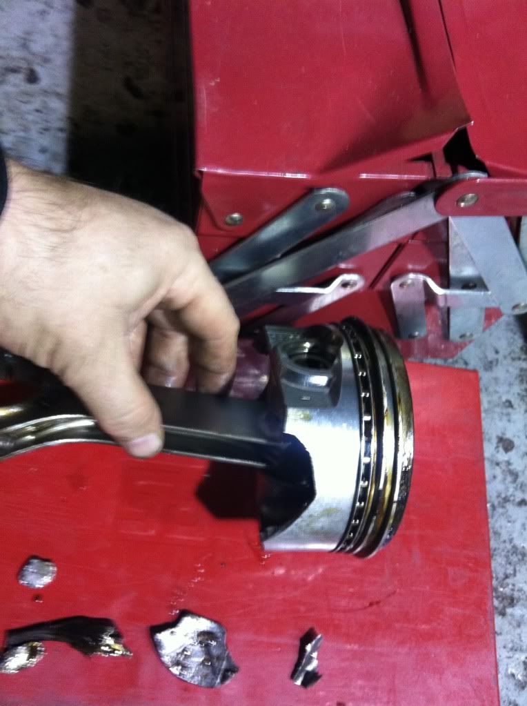

No.6 Piston is toast :(

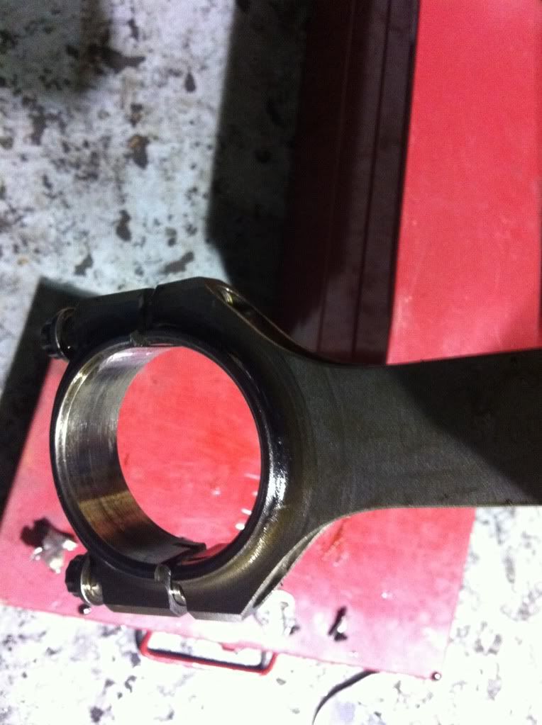

No. 6 Rod needs re-sizeing or re-placing

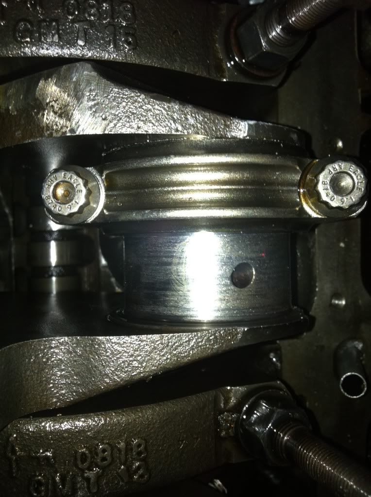

Crankshaft is Brown Bread

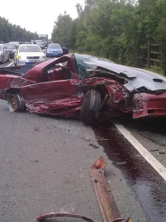

some will remembr Jack and his 11 sec Firebird

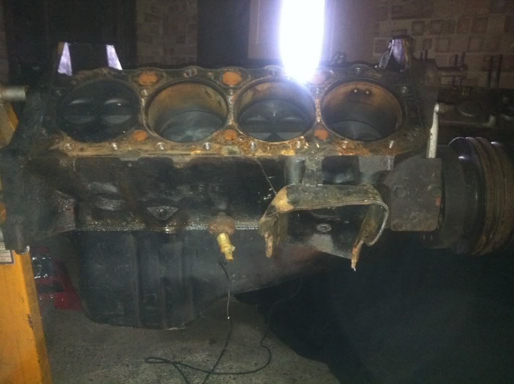

then this happened, Jack's ok and no one else was hurt either but the Bird is toast
Jack has done me a fantastic deal on the engine, NOS kit and varrious other bits
see how bent the engine mount is :shock: :shock:
and a bit broken off the back but should be ok, it's a bit lighter now ;)

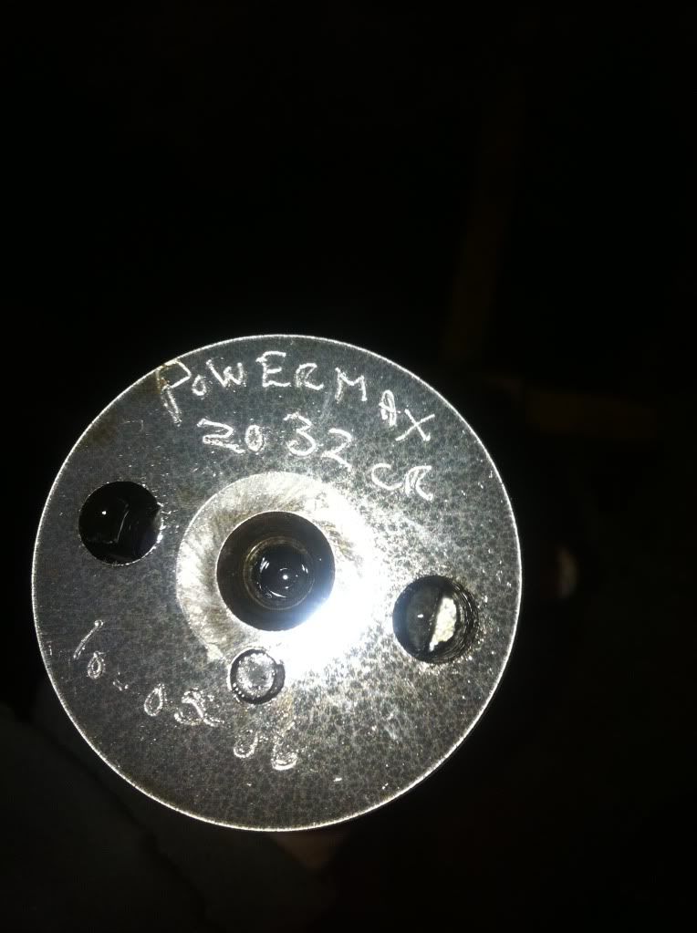

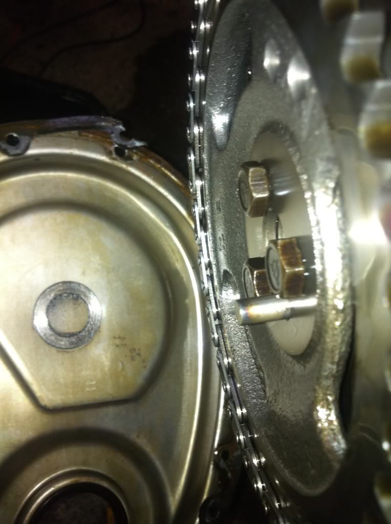

It's an OEM Roller Cam engine
The long dowel had chewed into the timing cover which shouldn't happen as roller cams have retainer plates so don't need even a thrust button? so I don't know why it had such a long dowel? Some one enlighten me if I'm wrong please.
The Cam is quite good for a computer controlled car ( Crane Powermax 2032 ) and it will stay in as my budget won't stretch to a more suitable one for my set up, they cost five billion dollars each and my budget is three haypennies and a sixpence :lol:

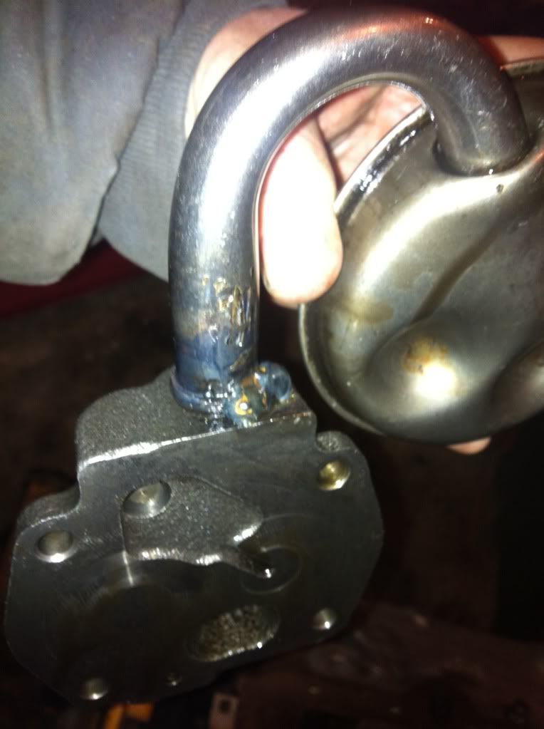

Oil pump pickup,
I knackered an engine once because the pickup fell off so I now stick them in place with a bit of snot.
Big thanks to Roy as I turned up at his, un-anounced at a really bad time ( I mean really bad ) and he welded the pickup when it really was the last thing he needed that day

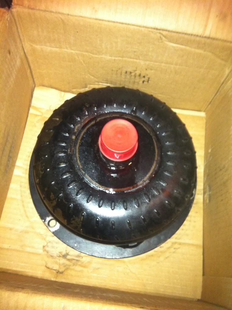

And then Roy did me a super special deal on a Torque converter to try :P :P

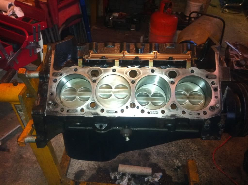

The engine is a bit cleaner now and I have to decide whether to put my AFR heads on or my old cast iron jobs which I ported myself?
 Post Posted: February 26th, 2012, 12:37 am
i may stick these cast irons on then I can leave this as a working unit when I take it out or I will have to take it apart again if I put the AFR ones on to build the 400
I did alot of work on the exhaust ports as I used them on my nitrous engines. Intakes weren't to shabby though for an amateur with a hobby drill and 200 Marlboro blowing smoke through to get a nice cone shape round the valves :P
I ran a 10.9 with these heads on a 355 with cast pistons and stock rods
they need a bit of a clean

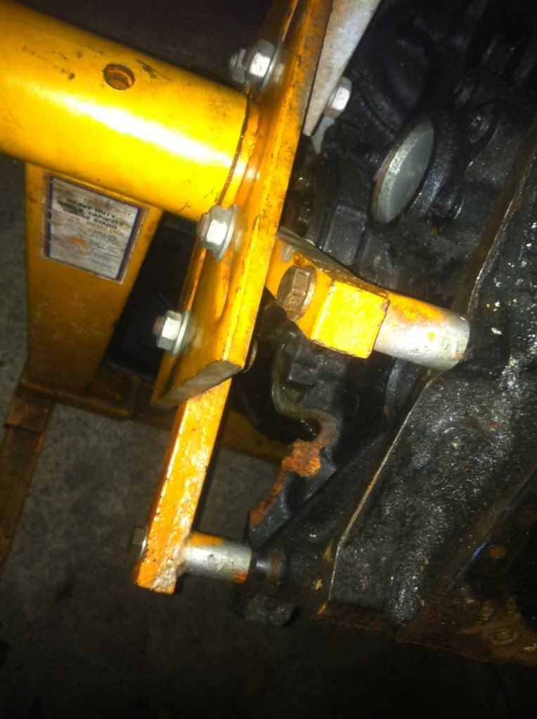

I got this off Jack aswell, the weight difference is amazing :shock:
