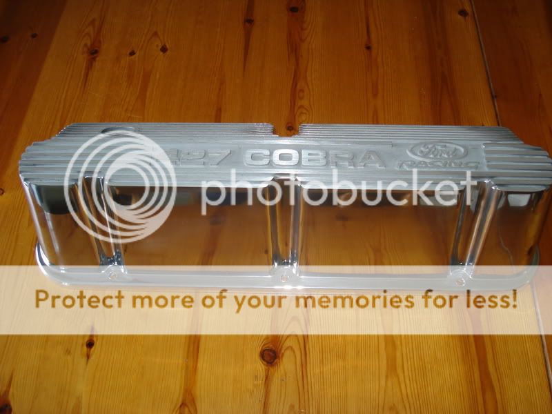

Oh and for the ford guys some FE style pent roof covers :)

like the rocker covers sean

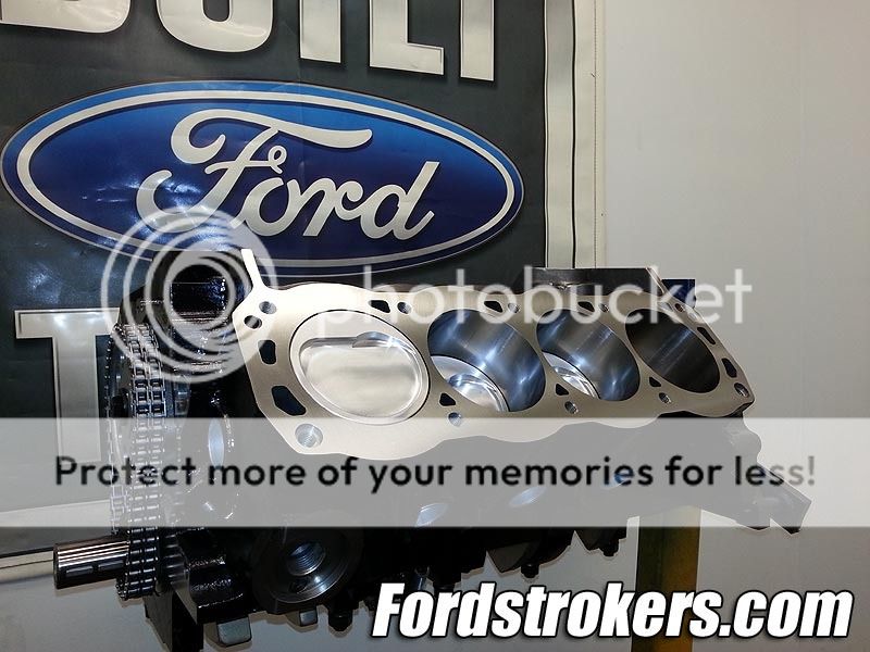

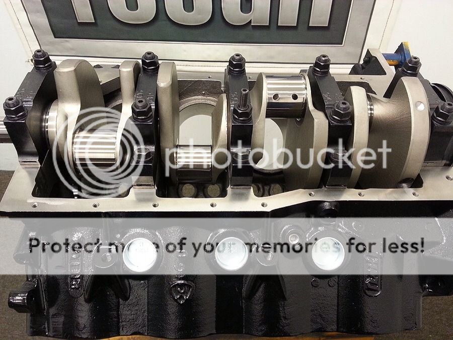

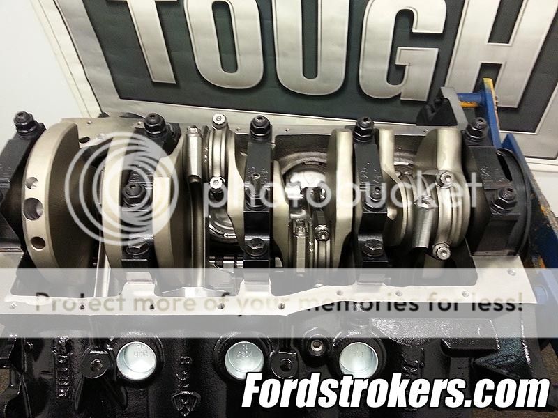

Well engine is near done, just to mill, clean repaint my Intake. Roll on 2014 :roll:
Dart Block machined, painted.
RPM 4340 internal balance crank
4340 H beams, custom Hyd roller, SA billet timing gear
Custom Wiseco 2618 22cc dish slugs, rings gapped for nitrous ;) intake valve reliefs needed re- cutting. Should be good for 10.8-1 comp.
Long block done, Total Engine Airflow Trickflow 225 Highports, PAC spring upgrade titanium retainers. Trend pushrods, Morel link bar roller lifters, Victor water pump, Comp Ultra Gold rockers, Powerbond internal SFI balancer, Moroso street/strip pan. Got polished covers but got some black ones too. ARP mains,head studs, Felpro MLS head gaskets.

8-) 8-) 8-) 8-)
I like the pic of the bottom end TOUGH :evil:

Hi Andy, hope to catch up for a beer at the mopars bud ;) yeh didn't fancy cap walk further down the line. Stock 351w block correctly machined can take 600 + BUT throw spiky nitrous in there on the 2 bolt caps, which like the 3" mains limit rpm to an extent before they 'walk'.
Block up grade gives me 4 bolt, 4.125 bore, 2.75 mains and 0 internal balance over 28 oz external.
Stayed with a hyd roller as opposed to TLSR cam as I drive it 140 miles round trip to the pod. Would be one thing checking/keeping on top of valve lash, but still sceptical of prolonged idle time on solid roller lifters, yeh there are new improved oiling ones out there but very expensive, and costly if one eats go :o
So sticking with stick and as the yanks say "girly hyd roller" :roll:
